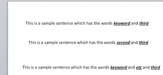

I ended up finding my answer through the MSDN, but it was very close to the answer I selected as correct from what people submitted.
Here is the code I went with:
Sub Keywords()
Dim TargetList
Dim element As Variant
TargetList = Array("First", "Second", "Third", "Etc")
For Each element In TargetList
For Each sld In Application.ActivePresentation.Slides
For Each shp In sld.Shapes
If shp.HasTextFrame Then
Set txtRng = shp.TextFrame.TextRange
Set foundText = txtRng.Find(FindWhat:=element, MatchCase:=False, WholeWords:=True)
Do While Not (foundText Is Nothing)
With foundText
.Font.Bold = True
.Font.Color.RGB = RGB(255, 0, 0)
End With
Loop
End If
Next
Next
Next element
End Sub
Turns out that code worked, but was a performance nightmare. The code I selected as the correct answer below runs much more smoothly. I've adjusted my program to match the answer selected.
