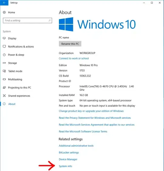

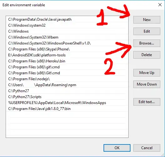

If you find that when you restart your computer, this solution will not work anymore:
Set the Path like as following:
Step 1 - Click on the
Windowsicon
Step 2 - Click on the
Settingsicon
Step 3 - Click on
System
Step 4 - Click on
About
Step 5 - Click on
System info
Step 6 - Click on
Advanced system settings
Step 7 - Click on
Environment variables...
Step 8 - Select
Pathrow and then clickEdit
Step 9 - Click
Newand then clickBrowse, then in the next panel which will open you need to select the folder you want in thePath. For the initial premise of this guide i will add the folderC:\Users\NewFolderInPath♥Note: Replace your PHP installed path(e.g:
C:\Program Files\php) with the above path ♥.
Step 10 - Click
OKand click everyOKbutton you will encounter to close every previous windows.
