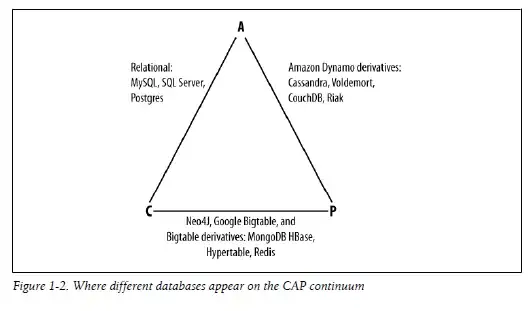

To explain the difference better I'd like to borrow a picture from Cassandra: the Definitive Guide, where they go over the CAP theorem. What they say is basically for any distributed system, you have to find a balance between consistency, availability and partition tolerance, and you can only realistically satisfy 2 of these properties. From that you can see that:

To put a little color to the picture, I've been using both at my job in the same infrastructure, and HBase has a very different purpose than Cassandra. I've used Cassandra mostly for real-time very fast lookups, while I've used HBase more for heavy ETL batch jobs with lower latency requirements.
