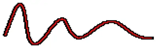

When I saw this "hole" in my stroke, I decided to draw my points again, but this time, by using ellipse with width and height set to 1 by using redPen with width set to 0.1f. So right after the code above I added the following code:
Pen redPen(Color::Red);
redPen.SetWidth(0.1f);
for (UINT i = 0; i < stroke.size(); ++i)
// draw point:
graphics.DrawEllipse(&redPen, stroke[i].X, stroke[i].Y, 1, 1);
And the new stoke I've got looked like this:
When I use Graphics.DrawRectangle instead of DrawEllipse while drawing this new red stroke, it never happens that this stroke (drawn by drawing rectangles) would have different width or holes in it:
I can't think of any possible reason, why drawing circles would result into this weird behaviour. How come that stroke is always continual and never deformed in any way when I use Graphics.DrawRectangle?
Could anyone explain, what's going on here? Am I missing something?
