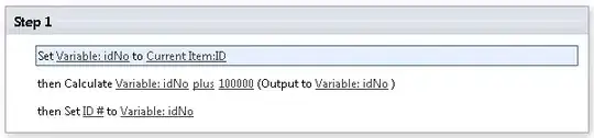

To generate one picture like the picture below, i have to do a pixel matrix (with weight), interpolate the data, group pixels together (by color range) and then join the points do draw the curves and put the reference text values like this?
If i need to do this pixel matrix, it will be very expensive for a giant interpolation, so can I do less points and use splines to join then to create the color levels?
