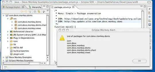

I can get the property when I use the customized control in other projects (as you can see in the image); but configuration parameter DefaultValue seems not to work.

One curiosity: please check the format of 'Cancel' text. If I set DefaultValue type; it looks like normal text. But if I don't, it looks like bold text. I know it's silly; but I would like to know why it is that way. Thank you.
