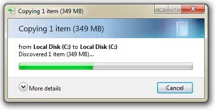

Here is my favorite way of doing it... Using the SHFileOperation API
This API will automatically show the progress as shown in the screenshot below.

Screenshot
