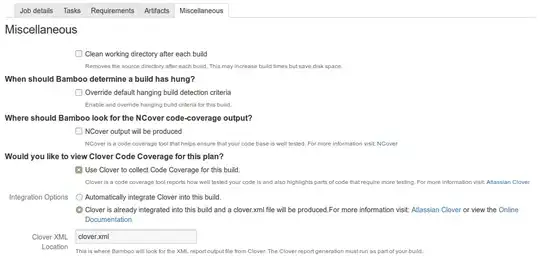

Coverage configuration is done other way.
- Open Miscellaneous tab of your job
- Check Use Clover to collect Code Coverage for this build
- Select Clover is already integrated into this build and a clover.xml file will be produced
- Type
clover.xml into Clover XML Location
