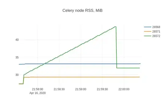

Then I use sqliteviz (pre-built version) to visualise what procpath has recorder. I drop the celery.sqlite there and use this query:
SELECT datetime(ts, 'unixepoch', 'localtime') ts, stat_pid, stat_rss / 256.0 rss
FROM record
And in sqliteviz I create a line chart trace with X=ts, Y=rss, and add split transform By=stat_pid. The result chart is:
This shape is likely pretty familiar to anyone who fought with memory leaks.

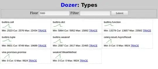

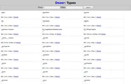

Opening http://localhost:8000 in a browser there should see something like:
After that I run python demo.py from (4) again and wait for it to finish. Then in Dozer I set "Floor" to 5000, and here's what I see:
Two types related to Celery grow as the subtask are scheduled:
celery.result.AsyncResult
vine.promises.promise
weakref.WeakMethod has the same shape and numbers and must be caused by the same thing.

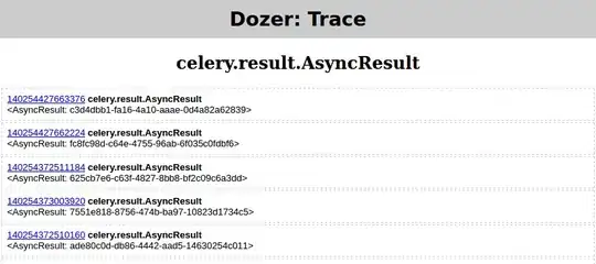

- I run
- in Dozer I set
floor=0, filter=AsyncResult
- and click "TRACE" which should yield

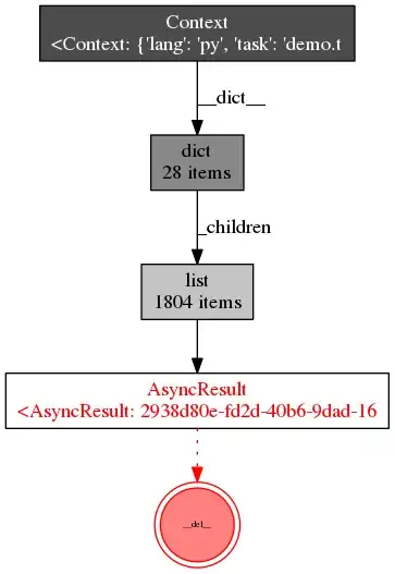

Then in Pyrasite shell run:
objgraph.show_backrefs([objgraph.at(140254427663376)], filename='backref.png')
The PNG file should contain:

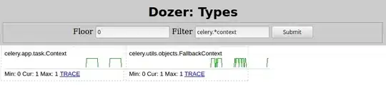

Basically there's some Context object containing a list called _children that in turn is containing many instances of celery.result.AsyncResult, which leak. Changing Filter=celery.*context in Dozer here's what I see:
So the culprit is celery.app.task.Context. Searching that type would certainly lead you to Celery task page. Quickly searching for "children" there, here's what it says:
