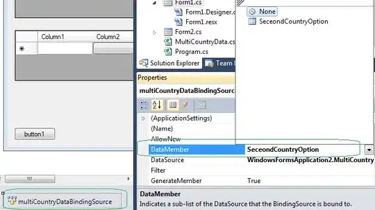

The thing is, some of the columns in dataGridView1 are Combo Box Columns, so the user can select a correct value. When I try adding the items array, I get an exception: "The following exception occurred in the DataGridView: System.ArgumentException: DataGridViewComboBoxCell value is not valid."
I know the combo box was added correctly with the correct data source, since if I just add a few items in the items array to the dataGridView1, like just items[0], the combo box shows up fine and there's no exception thrown. I guess the problem is when I try adding the incorrect value in the items array to the dataGridView1 row.
I'm not sure how to deal with this. Is there a way I can add all of the items in items except for that value? Or can I add the value from items and have it show up in the combo box cell, along with the populated drop down items?
