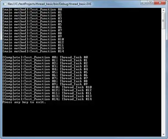

The BackgroundWorker is nice when developing for Windows Forms.
Say you wanted to pass a simple class back and forth:
class Anything {
// Number and Text are for instructional purposes only
public int Number { get; set; }
public string Text { get; set; }
// Data can be any object - even another class
public object Data { get; set; }
I wrote up a short class that does the following:
- Create or Clear a list
- Start a loop
- In loop, create a new item for the list
- In loop, create a thread
- In loop, send the item as a parameter to the thread
- In loop, start the thread
- In loop, add thread to list to watch
- After loop, join each thread
- After all joins have completed, display the results
From inside the thread routine:
- Call lock so that only 1 thread can enter this routine at a time (others have to wait)
- Post information about the item.
- Modify the item.
- When the thread completes, the data is displayed on the console.
Adding a delegate can be useful for posting your data directly back to your main thread, but you may need to use Invoke if some of the data items are not thread safe.
class AnyTask {
private object m_lock;
public AnyTask() {
m_lock = new object();
// Something to use the delegate
public event MainDelegate OnUpdate;
public void Test_Function(int count) {
var list = new List<Thread>(count);
for (var i = 0; i < count; i++) {
var thread = new Thread(new ParameterizedThreadStart(Thread_Task));
var item = new Anything() {
Number = i,
Text = String.Format("Test_Function #{0}", i)
thread.Start(item);
list.Add(thread);
foreach (var thread in list) {
thread.Join();
private void MainUpdate(Anything item, bool original) {
if (OnUpdate != null) {
OnUpdate(item, original);
private void Thread_Task(object parameter) {
lock (m_lock) {
var item = (Anything)parameter;
MainUpdate(item, true);
item.Text = String.Format("{0}; Thread_Task #{1}", item.Text, item.Number);
item.Number = 0;
MainUpdate(item, false);
To test this, create a little Console Application, and put this in the Program.cs file:
// A delegate makes life simpler
delegate void MainDelegate(Anything sender, bool original);
class Program {
private const int COUNT = 15;
private static List<Anything> m_list;
static void Main(string[] args) {
m_list = new List<Anything>(COUNT);
var obj = new AnyTask();
obj.OnUpdate += new MainDelegate(ThreadMessages);
obj.Test_Function(COUNT);
Console.WriteLine();
foreach (var item in m_list) {
Console.WriteLine("[Complete]:" + item.Text);
Console.WriteLine("Press any key to exit.");
Console.ReadKey();
private static void ThreadMessages(Anything item, bool original) {
if (original) {
Console.WriteLine("[main method]:" + item.Text);
} else {
m_list.Add(item);
Here is a screenshot of what I got with this:
I hope others can understand what I've tried to explain.
I enjoy working on threads and using delegates. They make C# a lot of fun.
