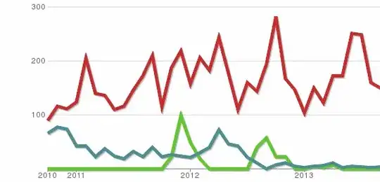

One more thing is the activity of the community. Compare the mailing list traffic for axis and cxf (2013).
So if this is any indicator of usage then axis is by far less used than cxf.
Compare CXF and Axis statistics at ohloh. CXF has very high activity while Axis has low activity overall.
This is the chart for the number of commits over time for CXF (red) and Axis1 (green) Axis2 (blue).
