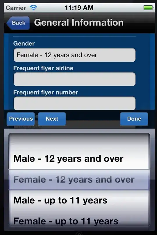

phix mentioned the UITextField/UIPicker Combo like this

One option would be a segmented control, but that gets too large when you have many options.
I'd recommend to use a customized UITextfield with a UIPickerView as inputView. So the user can only select the text from the picker, not through the keyboard.
It's also possible to do that with a UIButton, that would require to subclass UIButton.
Here is a tutorial on how to achieve this: http://nomtek.com/tips-for-developers/working-with-pickers/
