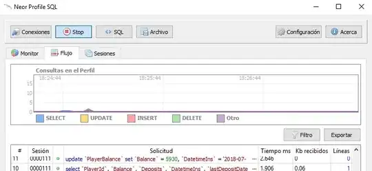

On Rubymine 7.1, using a Mac, I found it under:
- Preferences --> Editor --> General --> Appearance
Near the top is a Show line numbers checkbox. See illustration.
