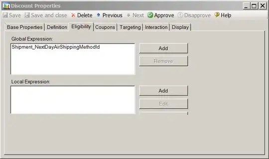

Enticify adds the concept of Shipment Expressions. You use these like you do Eligibility Expressions (you actually set them in the Marketing Manager Eligibility tab). However, you can make a discount shipping method specific by targeting properties like shipping_method_id.
Here you see the shipment expression targeting the shipping_method_id (but you could target other shipment properties):
And here you see it listed in the eligibility expressions dialog:
When run, this discount will only apply to shipments that meet this expression. You can read more in the Enticify Shipping Discounts documentation. This is quite powerful, as it can be used to qualify product discounts too (e.g. get a discount on product X when you choose next day shipping).
