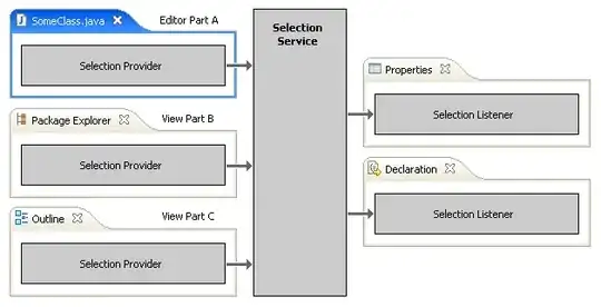

What you should do then is to ask the workbench for the current selection. I guess your view is opening on a double click action or simple selection so the object you want to manage in your view will be currently selected.
This is how you could retrieve the workbench selection from your view :
ISelection s = this.getSite().getWorkbenchWindow().getSelectionService().getSelection();
where "this" is a ViewPart.
Then you have to make your initial view (the one initiating the view creation from a given event like DoubleClick) a selection provider. A JFace viewer is a selection provider, so you can use it if you're using jface, or you can implement the ISelectionProvider interface when you're using custom SWT controls (that was my case).
The article "Eclipse Workbench: Using the Selection Service" can also give you some pointers.
