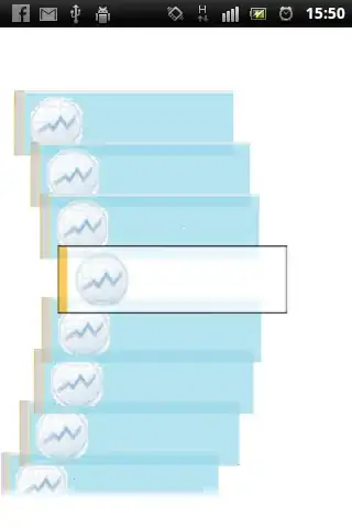

How to create listview like this in android 1.6 or 2 (because of renderscript, which works only in 3 or later, but I need list to work on almost all androids):
I used Camera.setTranslate(x, 0, z) in drawChild, where changed x position for rotation virtualization and z for overlaping. Then there was problem with overlapping, because last item was on top and first on bottom layer. So, in onCreate() method called this.setChildrenDrawingOrderEnabled(true) and overriden protected int getChildDrawingOrder (int childCount, int i) {} where I could change order for middle and later rows.
This idea was given by Renard, who suggested me in other my post about almost same thing here.
My getChildDrawingOrder(int, int) implementation to get overlapping I need:

I hope this post will help someone in future
Screenshot is actually almost the same as I mentioned in my question. I used alpha, so overlayed items is a little bit see-through:
