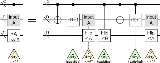

There is no circuit that performs the mod operation reversibly. You need to keep your numbers mod'ed the whole time. For example, instead of using an adder and then attempting to mod, use a fundamentally modular adder.

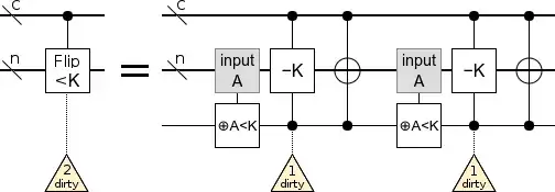

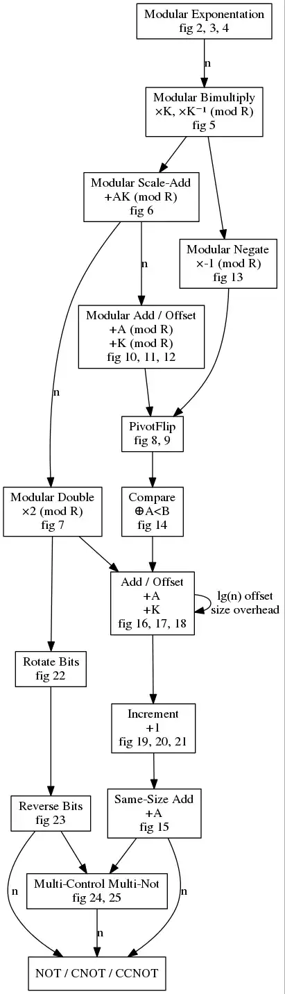

There's actually quite a lot of detail that goes into constructing these circuits. Too much for an answer here. A preprint that goes through all the details (and had working ProjectQ code at the time) is "Factoring with n+2 clean qubits and n-1 dirty qubits".
Here's a few example diagrams:
Note that the constructions are really going out of their way to avoid using ancillae, so they often have not-so-great gate counts.
And here's one to reinforce the point that it's complicated:
