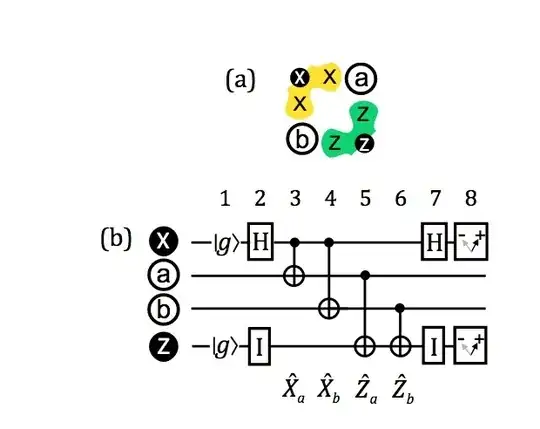

I am reading Fowler et al's paper on the surface code.. I do not understand how to initialize a logical qubit in an arbitrary state with the surface code. I do understand how to initialize the qubit in logical $|{0}\rangle$ and $|{1}\rangle$, but not how to initialize in an arbitrary superposition.
In Appendix B he shows that after the measurements in the circuit below,

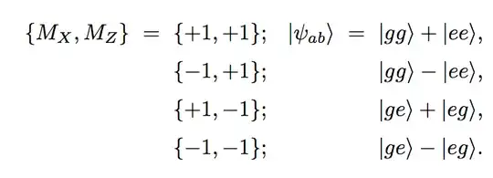

the middle two qubits are in the one of the following four states:
Can they also be in a superposition of one of these states?

Regarding measurement in your circuit: If the measurement is done in z-basis, the only four possibilites are those you listed in your question. Yes, qubits can be in superposition but after measurement, they end up in one of four combination of $|0\rangle$ and $|1\rangle$.
