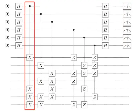

To implement a stabilizer code I need to measure stabilizer generators, as shown in Fig. 10.16 in Nielsen & Chuang. Is there a way for controlled multiqubit gates in qiskit? enter image description here

For doing that in Qiskit, first create a multi qubit gate as a custom gate:
from qiskit import *
x_circuit = QuantumCircuit(3, name='Xs')
x_circuit.x(range(3))
xs_gate = x_circuit.to_gate()
Then create a controlled version of that custom gate:
cxs_gate = xs_gate.control()
Finally, use that controlled custom gate in a circuit:
circuit = QuantumCircuit(8)
circuit.append(cxs_gate, [0,2,6,4])
print(circuit)

You can decompose one level to see how it works internally:
print(circuit.decompose())
q_0: ──■────■────■──
q_1: ──┼────┼────┼──
q_2: ┤ X ├──┼────┼──
q_3: ───────┼────┼──
q_4: ───────┼──┤ X ├
q_5: ───────┼───────
q_6: ─────┤ X ├─────
q_7: ───────────────

A general controlled unitary
Let $CU$ denote the 'controlled' version of the $n$-qubit unitary $U$:
\begin{equation} CU = |0\rangle\langle0|\otimes I_{t} + |1\rangle\langle1|\otimes U_{t}, \end{equation}
where the operation acts on a Hilbert space $\mathcal{H}_{c}\otimes \mathcal{H}_{t}$, with $c$ denoting the control qubit and $t$ denoting the target qubits (in your case, the data qubits). I have added a subscript $t$ in the equation as well to indicate this subsystem.
Normally, to implement $CU$ one needs to compile it to the gateset used by the platform on which it is implemented. Qiskit generally uses only two-qubit multi-qubit gates, so higher-dimensional gates need to be compiled. See for instance this previous question or the paper referred to in an answer there.
Shortcut for stabilizer readout
However, there is a shortcut for the unitary you describe: we can write $U = U_{i}^{\otimes n}$, where each $U_{i}$ is a single-qubit unitary (In your case, all $U_{i}$ are either $X$ or $I$); we can always write the unitary like this when concerning stabilizer codes.
Now we can rewrite $CU$ as: \begin{equation} CU = \prod_{i \in n}|0\rangle\langle 0| \otimes I_{i} + |1\rangle\langle 1| \otimes U_{i}. \end{equation}
That is to say, we can replace the entire multi-qubit controlled unitary by the succession of controlled version of all individual $U_{i}$'s.
That means for you that you can apply a controlled $X$ (or $I$) operation to every different data qubit, from your ancilla. Of course the controlled $I$ operation need not be actually performed.
