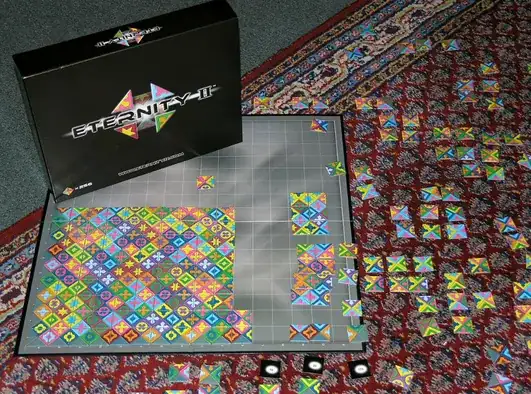

Eternity II
For example, in the particular puzzle there are $256$ tiles, each of which can be in one of four different orientations, with each of the four edges of each tile selected from among twenty-three colors; each color can be represented with one qudit with $d=23$, or alternatively five qubits because $2^4\lt 23\lt 2^5$. Naively, each tile can be represented by a register of, say, $4\times 5=20$ qubits for (orientation$\times$color), and we have $256$ such tiles, for a total of at most $20\times 256=5120$ qubits to represent a state of the puzzle. Calling "valid puzzle-state" a permutation of the $256$ tiles laid out in a $16\times 16$ grid and a "solved state" a permutation of the $256$ tiles laid out in the $16\times 16$ grid to satisfy the edge-matching rules, these $5120$ qubits can be in superposition representing the puzzle, whether solved or not (indeed, whether a valid puzzle-state or not).
With such edge-matching puzzles, a local Hamiltonian almost immediately presents itself - in particular, we should add an energy penalty anytime neighboring edges don't match. Although I haven't studied the D-Wave paper mentioned in the comments, I suspect that D-Wave proposes to stoquastically evolve from a uniform superposition to the ground state of such a local Hamiltonian.
Another idea that may be worth considering is to consider a quantum walk along the state-space of all valid puzzle-states. For example, we can consider generators of $S_{256}$ - the symmetric group on the $256$ tiles, as well as generators of $C_4$ - the cyclic group of the four edges. A classical walk on such a Cayley graph is akin to a person starting with a puzzle-state and randomly SWAPing and/or rotating pieces. To get a continuous-time quantum walk we can trotterize over small root-of-SWAPs and root-of-rotations with respect to these generators, to simulate such a Hamiltonian. If we start in a valid puzzle-state initially, then we stay in the subspace of all valid puzzle-states by walking along this Cayley graph. Indeed we can prepare a $5120$-qubit register in a superposition over two puzzle-states and run a quantum phase estimation protocol to see if we can learn anything neat about the particular generators and the particular tiles in the puzzle.
