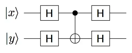

Consider the following circuit, acting on some standard basis state $\ket{x}\ket{y}$ provided as input:
Circuit illustrating control-target inversion of a CNOT gate using Hadamards
To smooth the analysis slightly for those who haven't seen a lot of quantum computation, let's consider how we could most easily represent the effects of these operations on some states.
  • The middle gate, which is a $\mathrm{CNOT}$ gate ("controlled-not"), performs the following transformation of standard basis states: $$ \mathrm{CNOT} \ket{x}\ket{y} = \ket{x}\ket{y \!\oplus\! x}$$ and performs the same transformation, independently, on each term of a superposition of standard basis states. This aspect of performing things independently on individual terms is what is sometimes described as the 'parallel' behaviour of quantum computation.
  • The gates surrounding the $\mathrm{CNOT}$ gate in the circuit are Hadamard gates, $ H = \tfrac{1}{\sqrt 2}\bigl[\begin{smallmatrix} 1 & \phantom- 1 \\ 1 & -1 \end{smallmatrix}\bigr], $ which we may describe as performing the following transformation on standard basis states: $$ \ket{x} \;\xrightarrow{\;H\;}\; \tfrac{1}{\sqrt 2}\Bigl( \ket{0} + (-1)^x \ket{1} \Bigr) .$$ On pairs of standard basis states, we may represent the effect of Hadamards on both qubits by $$ \ket{x}\ket{y} \;\xrightarrow{\;H \otimes H\;}\; \tfrac{1}{2}\Bigl( \ket{00} + (-1)^y \ket{01} + (-1)^x \ket{10} + (-1)^{x \oplus y} \ket{11}\Bigr); $$ and because the Hadamard gate is self-inverse, we also have the reverse transformation of states, $$ \tfrac{1}{2}\Bigl( \ket{00} + (-1)^y \ket{01} + (-1)^x \ket{10} + (-1)^{x \oplus y} \ket{11}\Bigr) \;\xrightarrow{\;H \otimes H\;}\; \ket{x}\ket{y}. $$
So: given these observations, let's take a look at what happens when we perform the circuit illustrated above on an input state $\ket{x}\ket{y}$: reading off transformations of the state, time-step by time-step, we have $$ \begin{align} & \ket{x}\ket{y} \\[1ex]&\xrightarrow{\;H \otimes H \;} \tfrac{1}{2}\Bigl( \ket{00} + (-1)^{y} \ket{01} + (-1)^x \ket{10} + (-1)^{x \oplus y} \ket{11}\Bigr) \\[1ex]&\xrightarrow{\;\mathrm{CNOT} \;} \tfrac{1}{2}\Bigl( \ket{00} + (-1)^{y} \ket{01} + (-1)^x \ket{11} + (-1)^{x \oplus y} \ket{10}\Bigr) \\&\qquad\qquad= \tfrac{1}{2}\Bigl( \ket{00} + (-1)^{y} \ket{01} + (-1)^{x\oplus y} \ket{10} + (-1)^{x} \ket{11}\Bigr) \\&\qquad\qquad= \tfrac{1}{2}\Bigl( \ket{00} + (-1)^{y} \ket{01} + (-1)^{(x\oplus y)} \ket{10} + (-1)^{(x\oplus y) \oplus y} \ket{11}\Bigr) \\[1ex]&\xrightarrow{\;H \otimes H \;} \ket{x \!\oplus\! y}\ket{y}. \end{align}$$ In the middle of the computation, we have a superposition of standard basis states, and $\mathrm{CNOT}$ can be said to be operating independently on each of them. But if we were to describe this as "parallel computation", you should ask yourself:
