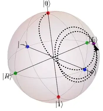

If you want something a bit more fancy, you can take the code I used in this answer to draw a better looking Bloch sphere, which would give something like the following:
Finally, if you want some animation, you can try something like the following (where I'm also adding the green line to denote the instantaneous eigenvector of the Hamiltonian):
hamiltonian[t_] := pauliZ + t pauliX;
initialState = {1, 0};
timesList = Range[0, 4, 0.01];
With[{points = Table[
    decomposeInPauliBasis@
     simulateStateEvolution[hamiltonian, t, initialState],
    {t, timesList}
 Animate[
  Graphics3D[{
    {Orange, Opacity@0.2, Sphere[{0, 0, 0}, 1]},
    {Red, PointSize@0.02, Point@points[[1]]},
    {Purple, PointSize@0.02, Point@points[[idx]]},
    {Darker@Green, Thickness@0.01,
     InfiniteLine@{-#, #} &@
       First@Eigenvectors@hamiltonian@timesList[[idx]]},
    {Dashed, Thickness@0.005, Tube@points[[;; idx]]}
    }, Axes -> True, AxesOrigin -> {0, 0, 0}, AxesStyle -> Black,
   Ticks -> None, Boxed -> False],
  {idx, 1, Length@points, 1}
(quality and smoothness can definitely be improved here)

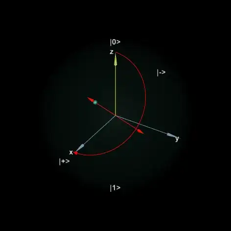

Let me plug my pet project: https://attilakun.net/bloch
It allows you to enter arbitrary 2x2 matrices and visualize how the quantum state is affected by them.
In the below example the red arc shows how the H matrix transforms the $|0\rangle$ state (yellow arrow) into $|+\rangle$:
Also, it's open source if you want to play around with the code: https://github.com/attila-kun/bloch
