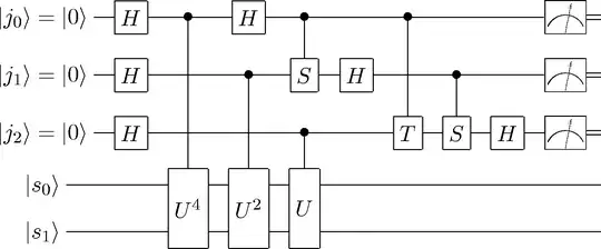

Using the example provided by Hastings:
      A short eigenvalue estimation circuit
Here is how you can compute the circuit depth, adding one gate at a time, to compute the length of the longest path that ends at a given qubit.

  2. For each gate in sequence (consistent with the input/output dependencies of the gates), take the maximum depth $d$ to that point on all of the qubits on which the gate acts, add one, and set the new max-depth on those qubits to that result. (If you are considering a unitary circuit with final measurements, and for some reason you want to use the convention of ignoring the depth-contribution of the measurements, then just don't count the measurements.) In the case of the circuit above, this yields:
    H 1:        [1, 0, 0, 0, 0]
    H 2:        [1, 1, 0, 0, 0]
    H 3:        [1, 1, 1, 0, 0]
    CU^4 1 4 5: [2, 1, 1, 2, 2]
    CU^2 2 4 5: [2, 3, 1, 3, 3]
    CU^1 3 4 5: [2, 2, 4, 4, 4]
    H 1:        [3, 2, 4, 4, 4]
    CS 1 2:     [4, 4, 4, 4, 4]
    H 2:        [4, 5, 4, 4, 4]
    CT 1 3:     [5, 5, 5, 4, 4]
    CS 2 3:     [5, 6, 6, 4, 4]
    H 3:        [5, 6, 7, 4, 4]
    Meas 1:     [6, 6, 7, 4, 4]
    Meas 2:     [6, 7, 7, 4, 4]
    Meas 3:     [6, 7, 8, 4, 4]
  3. Take the maximum of the depths ending at each qubit. In this case, it is qubit 3, with a depth of 8. With a little bit of work, by tracing how this depth arose, you can also find one or more particular paths through the circuit which yields this depth (e.g. H 1 ; CU^4 1 4 5 ; H 1; CS 1 2; H 2; CS 2 3; H 3; Meas 3).

It is the maximum time from input to output assuming all gates take 1 unit of time. So in this example:
Register 3 has 5 gates, but the 2nd gate (controlled-$U$) cannot be done until the controlled-$U^4$ and controlled-$U^2$ are done, so that adds 2 time steps. The controlled-$T$ can be done at the same time as the $H$, so there's no added time steps there. In total we have a gate depth of 7. If you include the measurement as a "gate", then the gate depth is 8.
