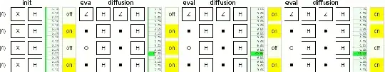

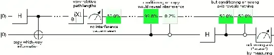

Craig Gidney's blog has some .gifs which directly link to the corresponding simulation on Quirk. For example:
Grover Search
Delayed Eraser
Is it possible to create these .gifs from within Quirk? Or does one need to use some third-party software?
