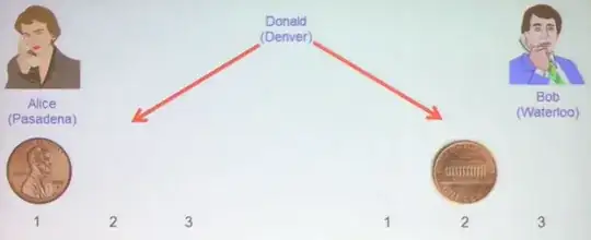

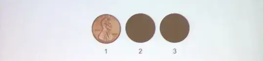

Three coins on the table. Each is either heads or tails. You can uncover any one of the three coins, revealing whether it is heads or tails but then you choose two the other two coins disappear --- you'll never know whetehr those two other coins are heads or tails.

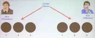

I'm a bit confused by Preskill's description of a Bell experiment [$\dagger$]. He describes a game, using correlated coins. Donald sitting in Denver manufactures three pairs of correlated coins. He then sends one set of coins (containing coin from each correlated pair) to Alice in Pasadena and another set of coins to Bob in Waterloo. Now according to the rules of the game: if Alice or Bob uncover any one coin from their set (to check if it's head or tails), the other two coins instantaneously disappear (and we can't ever know the states of those disappeared coins). Also, if Alice and Bob uncover the same number coin from their respective set (say if both choose coin number 2), they always observe the same side (i.e. either both get heads or both get tails).
There are many sets of coins, identically prepared by Donald (in Denver). For each of the three coins, in Pasadena or Waterloo, the probability is $\frac{1}{2}$ that the coin is heads or tails. But, if Alice and Bob both uncover the same coin, the outcomes are perfectly correlated. We know it always works, we've checked it a million times.
