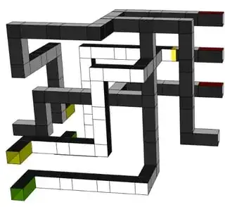

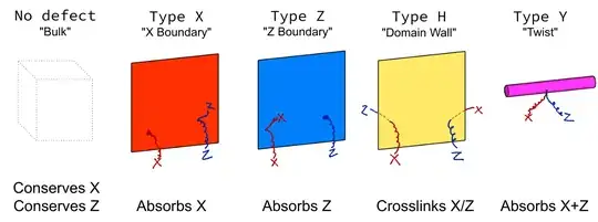

I like making diagrams to describe computations. For the surface code, an excellent tool is 3d topological diagrams. Here is an example diagram (made by me in SketchUp):
diagram
The basic idea is that white boundaries are places where Z observable chains can terminate, black boundaries are places where X observable chains can terminate, and the computation is defined by how these boundaries are merged/split/braided/etc (other colors are used for labeling.). There is a simple correspondence between the diagram and what a quantum computer running the surface code would actually be doing.
Although these diagrams are a good tool for describing topological computations, not everyone knows how to read them. Is there a reference I can point them toward when they ask?
An example of a paper using these diagrams is A bridge to lower overhead quantum computation (Fowler & Devitt, 2013).

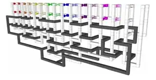

T factory
You may notice that the two diagrams I've included look different in their details. That's because the second one is using braiding whereas the first one is using lattice surgery. But it's ultimately the same diagrammatic concept.

Here's an unfinished slide deck I have on reading these diagrams: https://docs.google.com/presentation/d/1IjZ-0W9Y22wNG5036WFnnkF5Az1Zt8jTHFTC1-e7Em4/edit?usp=sharing

After reading Craig's answer above, you can understand 3d topological diagrams by reading Section II of Craig's paper "A SAT Scalpel for Lattice Surgery: Representation and Synthesis of Subroutines for Surface-Code Fault-Tolerant Quantum Computing"
