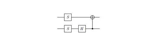

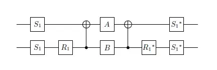

When a two qubit gate $W$ can be expressed (up to a global phase) in the computational basis by a matrix with entirely real entries, i.e., $W \in O(4)$, then there is general construction of implementing the gate with $CNOTs$ and single qubit gates, please see Vatan and Williams.
The construction is optimal in the sense that it requires two CNOT gates and at most 12 single qubit gates (for the most general case of a real two qubit gate). The construction is based on the homomorphism:
$$SO(4) \approx SU(2) \times SU(2),$$ which asserts that any two-qubit gate $W$ with real entries can be expressed as: $$W = M U M^{\dagger}$$ with $U\in SU(2) \otimes SU(2)$ , i.e., can be implemented by two single qubit gates.
A matrix $M$ inducing this homomorphism is named by Makhlin the magic matrix, one possible solution is given on the bottom of page 2 in Vatan and Williams work, another possibility is given in equation (10) by Fujii. Vatan and Williams gave a construction with one CNOT for $M$
Using this construction, the full gate implementation given by Vatan and Williams is:
with $S_1 = S_z(\frac{\pi}{2})$ and $R_1 = S_y(\frac{\pi}{2})$
Using this construction, it should be a quite an easy exercise to compute the one-qubit gates $A$ and $B$, for your case.

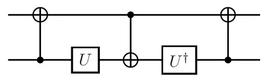

Neither of these gates require approximate sequences. You can implement them exactly with your specified gate sets with no great effort.
Up to a global phase (which should be irrelevant), G is simply $HSH$.
The second, $W$, is a little more complicated. The way that I constructed this was to think of it as a controlled-Hadamard where I then required a basis change which is created by a controlled-not. One therefore has the circuit
where $U=\cos\frac{\pi}{8}\mathbb{I}-i\sin\frac{\pi}{8}Y$. I always get factors of 2 wrong in these angles, but this is of the form $R_Y(\theta)$. I've taken no particular effort to optimise this gate sequence, but this is probably fairly good.
