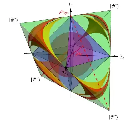

Geometric characterization (as any other characterization) of subsets of the quantum state space in relation with their locality and entanglement properties becomes very complicated as the number of qubits rises. The geometry of the space of negative conditional entropy two qubit states, which are also locally maximally mixed (Weyl states) is known; it is reviewed by Friis, Bulusu and Bertlmann. All the figures and the data given in this answer are taken from this review.
Their result is described in the following figure of the Weyl tetrahedron, which can be summarized as follows:
Weyl Tetrahedron
  1. The corners of the tetrahedron are the four Bell states.
  2. The center of the tetrahedron is the maximally mixed two qubit sate.
  3. The maximally mixed state is surrounded by what is called the Kuś-Życzkowski ball of maximally separable states whose unitary translates are also separable.
  4. The surface of the ball touches the double pyramid of separable states in the central points of its faces.
  5. The dark-yellow surface outside the double pyramid encloses the local states which cannot violate the CHSH inequality.
  6. The outer red surface encloses all the states with positive conditional entropy.

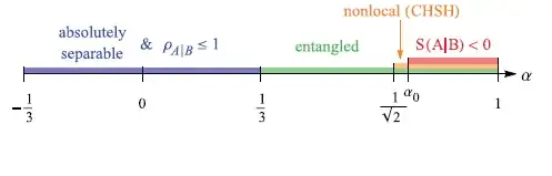

  7. The solid red line parametrizes a family of Werner states which penetrates through the whole Weyl tetrahedron. The cross section of this line in the tetrahedron is given by:
