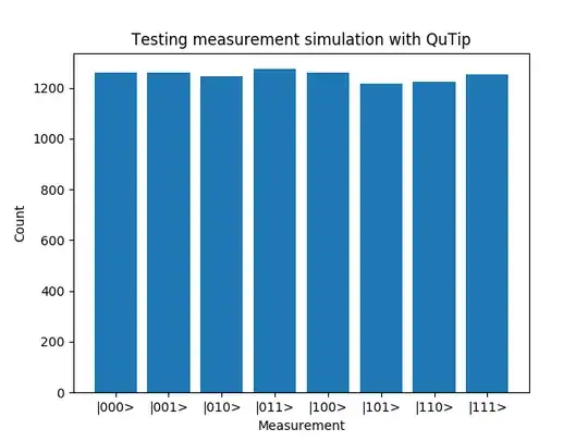

And this is how we apply our measurement simulation, let's perform 10000 measurements. Let's also calculate counts.
confs, P = prepareMeasurement(3, psif)
measurements = simulateMeasurement(confs, P, 10000)
unique, counts = np.unique(measurements, return_counts=True)
Visualize the data in histogram-like form.
fig, ax = plt.subplots()
ax.bar(unique, height=counts)
plt.xticks(unique, ["|{0}>".format(format(m, '03b')) for m in unique])
ax.set_title('Testing measurement simulation with QuTip')
ax.set_ylabel('Count')
ax.set_xlabel('Measurement')
plt.show()
This is what we're getting
histogram
I included everything in this public gist repository. Hope it helps!
