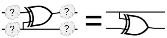

Here is a puzzle. Fill in the blanks to make these two circuits equal:
With bits, this is impossible. There is no single-input single-output process that can reverse the data-dependence direction.

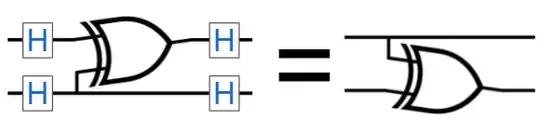

With qubits, this is trivial. You just use Hadamard gates. You can confirm this identity for yourself by checking that conjugating a controlled-not gate's matrix with swaps is equivalent to conjugating it with the Hadamard transform:
The very first quantum speedups that were discovered were based on this identity. For example, all the Deutsch–Jozsa algorithm does is use this identity to turn an unknown all-to-one effect into a one-to-all effect, in order to figure out what that effect is in one query instead of many queries.
This identity is just the simplest example of phase kickback. Refinements of the idea led to Simon's algorithm and ultimately to Shor's algorithm. And none of it works with bits because bits have no phase kickback.
