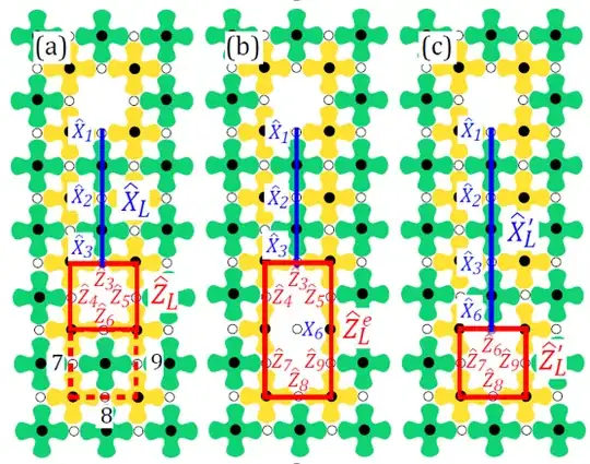

1 Cell Movement
The steps to move qubit in only 1 cell are:
1 - Finish full-cycle finish in all array
2 – before next cycle start – instruct software – "don’t mesure Z stab below"
3 – Also 2 X stabs are converted – 4 CNOTs -> 3
4 – Get X6 (measure X of Q6) used to track erros + influence new X_L
5 – turn on the Z stab above + arms of X stabs
6 – perform surface code cycle
7 – wait (d-1) cycles to establish stab value in time

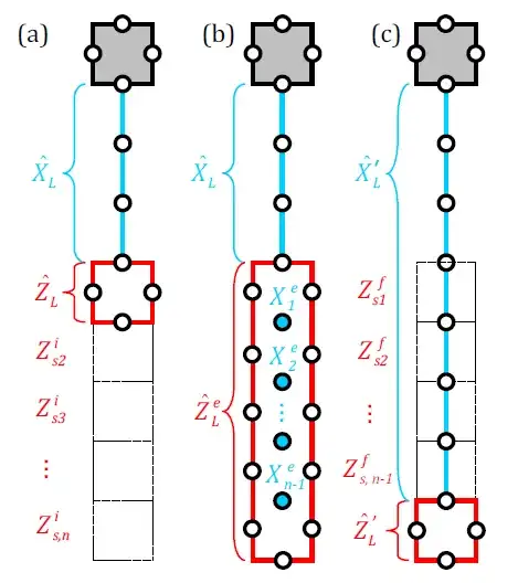

L Cells Movement
Multi_cell movement, done very quick because you turn the stabilizers off very quickly, in total $d+1$ cycles (2 for the turn on and off, + $(d-1)$ to stabilize fault-tolerance), and not dependent on the length of movement $L$. The time per each stabilizer cycle is limited mainly by the measurement time. All you have to make sure that your $\epsilon$ - the rate of physical failure, will be below the threshold
refer to the article "Surface codes: Towards practical large-scale quantum computation" to see more details
