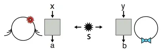

Continuing from my previous question on Brunner et al.'s paper (arXiv); so given a standard Bell experimental setup:
Bell experiment setup
where independent inputs $x,y \in \{0, 1\}$ decide the measurement performed by Alice & Bob on quantum state $S$ with outcomes $a,b \in \{-1, 1\}$, $a$ and $b$ are correlated (not independent) if: $$P(ab|xy) \ne P(a|xy)P(b|xy) \ne P(a|x)P(b|y)\tag1$$ Of course, there are perfectly innocent non-quantum reasons why $a$ and $b$ could be correlated; call these reasons confounding variables, some artifact of when Alice & Bob's systems interacted in the past. The set of all confounding variables we call $\lambda$. If we take into account all variables in $\lambda$, a local theory claims that $a$ and $b$ will become independent and thus $P(ab|xy)$ will factorize: $$P(ab|xy,\lambda) = P(a|x,\lambda)P(b|y,\lambda)\tag2$$ This equation expresses outcomes depending only on their local measurement and past variables $\lambda$, and explicitly not the remote measurement.
