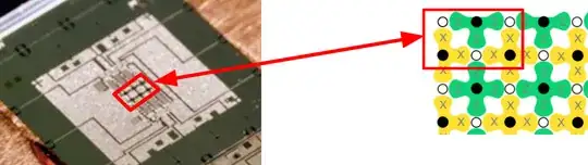

  1. Is a surface code an architecture onto which logical qubits, logical operations, and their connections are physically implemented? That is, is the common depiction of a surface code (the pattern of the measure qubits and data qubits) to be taken literally as a real-space image of the actual hardware or does it correspond to some abstraction in software that I'm not quite grasping?

is the common depiction of a surface code (the pattern of the measure qubits and data qubits) to be taken literally as a real-space image of the actual hardware?
Correct. The surface code is physically implemented by a planar grid of qubits.
hardware vs diagram
Left image source
