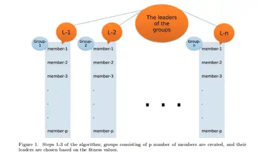

Let's consider the example of the Toffoli gate in section III-A in the first paper. We know from other sources such as this, that around 5 two-qubit quantum gates are needed to simulate the Toffoli gate. So we arbitrarily choose a set of gates like $\{V, Z, S, V^{\dagger}\}$. We restrict ourselves to a maximum of $5$ gates and allow ourselves to only use the gates from the gate set $\{V, Z, S, V^{\dagger}\}$. Now we generate $25$ groups of $15$ random strings like:
1 3 2 0.0; 2 3 1 0.0; 3 2 1 0.0; 4 3 2 0.0; 2 1 3 0.0
In the above string of numbers, the first numbers in bold are the index number of the gates (i.e. $V = 1, Z = 2, S = 3, Z^{\dagger} = 4$), the last numbers are the values of the angles in $[0,2\pi]$ and the middle integers are the target qubit and the control qubits respectively. There would be $374$ such other randomly generated strings.
Our groups now look like this (in the image above) with $n=25$ and $p=15$. The fitness of each string is proportional the trace fidelity $\mathcal{F} = \frac{1}{N}|\operatorname{Tr}(U_aU_t^{\dagger})|$ where $U_a$ is the unitary matrix representation corresponding to any string we generate and $U_t$ is the unitary matrix representation of the 3-qubit Toffoli gate. The group leader in any group is the one having the maximum value of $\mathcal{F}$.
Once we have the groups we'll follow the algorithm:

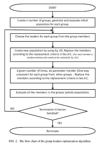

The Eq. (4) mentioned in the image is basically:
$$\text{new string} [i] = r_1 \times \text{old string}[i] + r_2 \times \text{leader string}[i] + r_3 \times \text{random string}[i]$$ (where $1 \leq i \leq 20$) s.t. $r_1+r_2+r_3 = 1$. The $[i]$ represents the $i$ th number in the string, for example in 1 3 2 0.0; 2 3 1 0.0; 3 2 1 0.0; 4 3 2 0.0; 2 1 3 0.0, the $6$-th element is 3. In this context, we take $r_1 = 0.8$ and $r_2,r_3 = 0.2$. That is, in each iteration, all the $375$ strings get mutated following the rule: for each string in each group, the individual elements (numbers) in the string gets modified following the Eq. (4).

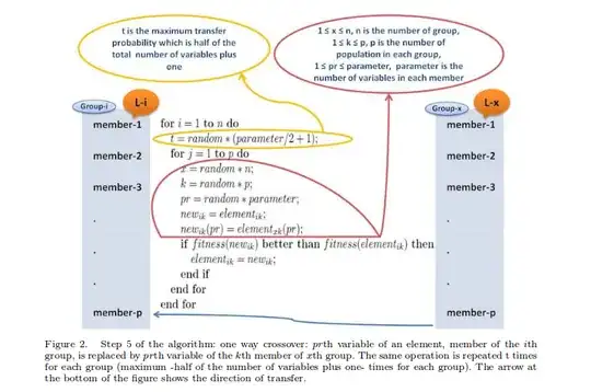

In addition to the mutation, in each iteration for each group of the population one-way-crossover (also called the parameter transfer) is done between a chosen random member from the group and a random member from a different random group. This operation is mainly replacing some random part of a member with the equivalent part of a random member from a different group. The amount of the transfer operation for each group is defined by a parameter called transfer rate, here, which is defined as $$\frac{4\times \text{max}_{\text{gates}}}{2} - 1$$ where the numerator is the number of variables forming a numeric string in the optimization.

The GLOA is just another genetic algorithms but with the difference of having different groups of population with a local optimum (leader as best candidate if you prefer) for each and of course a slightly different strategy for mutation/crossover. Usually, we have one group of candidates with one best candidate at each iteration.

3. I suggest looking at Figure 2 which shows the pseudo-code of this part to understand it. This is similar to one-way crossover in genetic algorithms. If you look at their original algorithm (GLOA, 2010), they choose a number $t$ between $1$ and half of the number of total parameters (variables) plus one. In this case, the number of parameters/variables is the length of a string which is $4 \times \text{max}_{\text{gates}}$. For the Toffoli gate, it was $5$. For other examples, it could have been more. But in general, they recommend $20$ as a good maximum (you can imagine how hard the optimization is with strings of more than $80$ variables on a simple computer).
For your visualization, look at the example string you give :
Here, a string represents a set of operations forming a circuit. We associate with it a fitness, which is related to the fidelity. It is like a candidate solution for our optimization problem. In that case, our $\text{max}_{\text{gates}}$ is $5$ because you see $5$ operations represented. Each operation is a gate of the set, the $2$ qubits it applies to and the angle if necessary, that is $4$ variables. In total, $5 \times 4 = 20$ variables for the problem.
1 3 2 0.0, in this case, means apply the $V$ gate on qubit $3$ controlled by qubit $2$ with an angle $0.0$ (note that with the $V$ gate there is no angle but say you were playing with like rotation gates, this becomes relevant).
4. This is also arbitrary depending on what you want. It can be a fixed number of iterations, or until you reach a threshold/convergence criteria.
