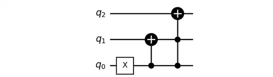

On second thought, implementing this unitary is a lot simpler than I initially anticipated.
As I mentioned in the comments, this unitary resembles that of a conventional decremeter circuit:
decrement
with unitary:
$$ U_{x-1} = \begin{bmatrix} 0 & 1 & 0 & 0 & 0 & 0 & 0 & 0 \\ 0 & 0 & 1 & 0 & 0 & 0 & 0 & 0 \\ 0 & 0 & 0 & 1 & 0 & 0 & 0 & 0 \\ 0 & 0 & 0 & 0 & 1 & 0 & 0 & 0 \\ 0 & 0 & 0 & 0 & 0 & 1 & 0 & 0 \\ 0 & 0 & 0 & 0 & 0 & 0 & 1 & 0 \\ 0 & 0 & 0 & 0 & 0 & 0 & 0 & 1 \\ 1 & 0 & 0 & 0 & 0 & 0 & 0 & 0 \\ \end{bmatrix} $$
This unitary differs from the one you want in that it maps:
$$ U_{x-1}|000\rangle = |111\rangle \; \text{ and } \; U_{x-1}|111\rangle = |110\rangle $$

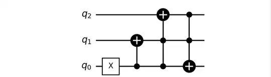

but you want:
$$ P|000\rangle = |110\rangle \; \text{ and } \; P|111\rangle = |111\rangle $$
So all you need is to add a $CCX$ gate to flip the least significant bit when the two most significant bits are $1$:
increment mod 7
This will give you the unitary you are looking for:
$$ P = \begin{bmatrix} 0 & 1 & 0 & 0 & 0 & 0 & 0 & 0 \\ 0 & 0 & 1 & 0 & 0 & 0 & 0 & 0 \\ 0 & 0 & 0 & 1 & 0 & 0 & 0 & 0 \\ 0 & 0 & 0 & 0 & 1 & 0 & 0 & 0 \\ 0 & 0 & 0 & 0 & 0 & 1 & 0 & 0 \\ 0 & 0 & 0 & 0 & 0 & 0 & 1 & 0 \\ 1 & 0 & 0 & 0 & 0 & 0 & 0 & 0 \\ 0 & 0 & 0 & 0 & 0 & 0 & 0 & 1 \\ \end{bmatrix} $$
