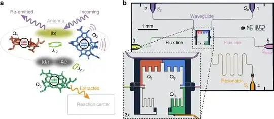

Quantum simulation can be used to test models that could describe certain biological process. For example, a 2018 paper by Potočnik et al. examined light harvesting models using superconducting quantum circuits (see figure below).
Currently, it's an open question whether quantum mechanics plays an important functional role in biological processes. Some candidate biological processes where quantum mechanics may have such a role include magnetoreception in birds, olfaction, and light harvesting.
Figure from the paper by Potočnik et al. 2018
