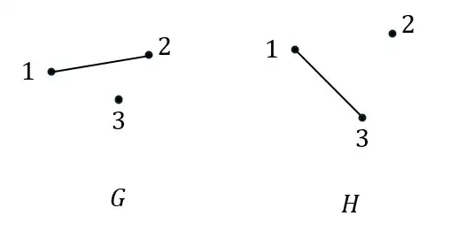

We will try to apply this approach to two labeled graphs $G$ and $H$ on three vertices as below. We wish to quantumly test whether these graphs are isomorphic, by preparing two states $|G\rangle$ and $|H\rangle$ corresponding to the uniform superposition of all permutations of $G$, respectively $H$. We'll see what happens when we do a SWAP test therebetween.
Two graphs on three vertices
Let's go in order; we'll begin with graph $G$, and then later work on graph $H$. At the end we will see what happens when we SWAP them.

  1. Let's now do exactly steps 1-4 above, but for $h$ instead of $g$. That is, we will prepare $|H\rangle$ by acting on $\mathbf{B}\mathbf{A}\mathbf{H}|00\cdots0\rangle|00\cdots0\rangle$, which, if I permuted correctly, gives: $$|H\rangle=\frac{1}{\sqrt 6}\big( |\begin{pmatrix} 0 & 0 & 1 \\ 0 & 0 & 0 \\ 1 & 0 & 0 \\ \end{pmatrix}\rangle|(1)\rangle+ |\begin{pmatrix} 0 & 0 & 0 \\ 0 & 0 & 1 \\ 0 & 1 & 0 \\ \end{pmatrix}\rangle|(12)\rangle+ |\begin{pmatrix} 0 & 0 & 1 \\ 0 & 0 & 0 \\ 1 & 0 & 0 \\ \end{pmatrix}\rangle|(13)\rangle+ |\begin{pmatrix} 0 & 1 & 0 \\ 1 & 0 & 0 \\ 0 & 0 & 0 \\ \end{pmatrix}\rangle|(23)\rangle+ |\begin{pmatrix} 0 & 1 & 0 \\ 1 & 0 & 0 \\ 0 & 0 & 0 \\ \end{pmatrix}\rangle|(123)\rangle+ |\begin{pmatrix} 0 & 0 & 0 \\ 0 & 0 & 1 \\ 0 & 1 & 0 \\ \end{pmatrix}\rangle|(132)\rangle\big). $$
  2. Lining up the matrices or alternatively lining up the permutations and taking the dot product lets us visually see that $\langle H|G\rangle=0$. Thus, the SWAP test between $|G\rangle$ and $|H\rangle$ won't tell you anything!
