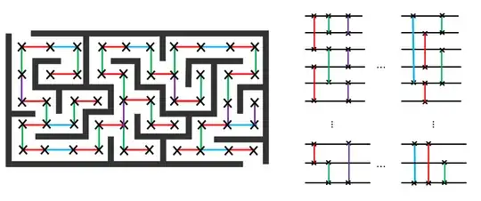

Let's help her out by edge-coloring each passageway with one of $4$ colors, red, green, light blue, or purple. Finks can randomly choose which color passageway she wishes to take (she can flip a classical, four-sided die to make the choice of each door).
We can model her behavior by placing SWAP gates along the passageway from room to room and having her randomly decide whether to do a red layer, a green layer, a purple layer, or a light blue layer at each step.

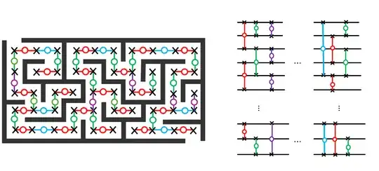

But even though she's been fighting a cold lately, Finks also has quantum superpowers. So she can still flip her classical four-sided die to decide which color hallway to walk, but instead of doing classical SWAP gates, she can perform some quantum square-root-of-SWAP gates.

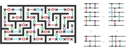

Finks is pretty smart, though, and she comes up with an idea. She decides to try to get the best of both classical and quantum behavior. So sometimes she will do a classical SWAP and sometimes she'll do a quantum SWAP as below:
By sometimes doing a classical SWAP and sometimes doing a quantum SWAP, can Finks get the best of both the classical world and the quantum world, finding the cheese faster but also being more likely to have settled into a stationary distribution? If so, what is the best way for her to get a stationary probability $\pi_n'$ preferably in $O(1/n)$, but also in the fastest time $t'$, preferably $O(\sqrt t)$?
