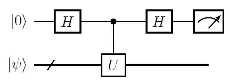

You are right about the extraction of the desired matrix element.
We have the hadamard test circuit
Hadamard test circit
Start with your equaition:\ $1/\sqrt{2})[|0\rangle \otimes |b\rangle + |1\rangle \otimes U|b\rangle]$
I will use $| \phi\rangle $ instead of b and $|0\rangle$ so the joint state becomes: $ \frac{1}{\sqrt{2}}\Big(|0\rangle \otimes |\psi\rangle \;+\; |1\rangle \otimes U|\psi\rangle\Big)\,. $ The final joint state (after the second Hadamard) is:
$ \frac{1}{\sqrt{2}}\Big[\;\frac{1}{\sqrt{2}}\big(|0\rangle+|1\rangle\big)|\psi\rangle \;+\; \frac{1}{\sqrt{2}}\big(|0\rangle - |1\rangle\big)U|\psi\rangle\;\Big]\,, $ which we can simplify as: $ \frac{1}{2}\Big[\,|0\rangle\otimes\!(|\psi\rangle + U|\psi\rangle) \;+\; |1\rangle\otimes\!(\,|\psi\rangle - U|\psi\rangle)\Big]\,. $
Now we measure the ancilla qubit in the $\{|0\rangle,|1\rangle\}$ basis. The probability of each outcome can be computed from the final state above by taking the norm squared of the corresponding branch:
Probability ancilla = $|0\rangle$: $ P(0) = \Big\|\,\frac{1}{2}\, (|\psi\rangle + U|\psi\rangle)\Big\|^2 \;=\; \frac{1}{4}\,\langle \psi| (I + U^\dagger)(I + U) |\psi\rangle\,, $
This simplifies to $ P(0) =\; \frac{1}{2}\Big(1 + \mathrm{Re}\,\langle\psi|U|\psi\rangle\Big)\,. $
The result is also found in this post What is a hadamard test
The measurement outcome for the ancilla can be treated as a random variable $Z_{\text{anc}}$ that takes value $+1$ if the ancilla is found in $|0\rangle$ and $-1$ if found in $|1\rangle$. From the probabilities derived, the expected value of this random variable is $ \mathbb{E}[Z_{\text{anc}}] \;=\; (+1)\,P(0) + (-1)\,P(1) \;=\; P(0) - P(1). \ $This is how we can compute matrix elements on a quantum computer: it turns an inner product containing a unitary into an observable (the ancilla’s $Z$) that we can measure. If in our problem we want to compute $\langle a|O|b\rangle$, we would identify $|\psi\rangle$ and $U$. Then we have: $|\psi\rangle = |b\rangle = U_b|0\rangle$ and $U = U_a^\dagger O U_b$. Then $\langle \psi|U|\psi\rangle = \langle b|\,U_a^\dagger O\,U_b\,|b\rangle = \langle a|O|b\rangle$.
