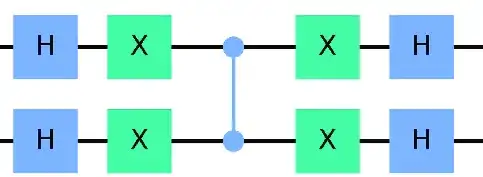

I am a newbie to quantum computing and recently came across Grover's algorithm. I'm now trying to understand its quantum circuit for 2 qubits.
I have understood the oracle which marks the correct answer with a negative sign. But I'm having a really hard time understanding the diffusion operator (see the image above).
I don't understand how to come up with this circuit, given the idea of reflection around the mean. I've tried to understand rotation around S and how to map it to this circuit but not able to see how.
Would someone please describe how to go from the diffusion operator's logic to creating this quantum circuit in an understandable, step by step manner? I've gone through countless articles that explain rotation around S with plenty of diagrams, operations and matrices; but none that I found explains how to convert all that to a quantum circuit, the thought process behind creating that circuit, and why that circuit works. Thanks in advance.

The Grover diffusion operator on 4 qubits is $$G=\frac12\begin{pmatrix}-1&1&1&1\\1&-1&1&1\\1&1&-1&1\\1&1&1&-1\end{pmatrix}=2|++\rangle\!\langle++|-I$$ with $|+\rangle$ being the uniform superposition on two qubits: $$|+\rangle=H|0\rangle=\frac{|0\rangle+|1\rangle}{\sqrt{2}}\,.$$ Using this second equation, notice what happens when you surround $G$ by Hadamard gates: $$\begin{align*} H^{\otimes2}GH^{\otimes2}&=H^{\otimes2}\left(2|++\rangle\!\langle++|-I\right)H^{\otimes2}\\&=2|00\rangle\!\langle00|-I\\&=-\begin{pmatrix}-1&0&0&0\\0&1&0&0\\0&0&1&0\\0&0&0&1\end{pmatrix}\end{align*}\,.$$ Thus, $H^{\otimes2}GH^{\otimes2}$ is a gate that, up to an irrelavant global phase of $-1=\mathrm{e}^{\mathrm{i}\pi}$, flips the phase of the $|00\rangle$ state and leaves the other ones intact. This really looks like the $CZ$ gate, that flips only the phase of the $|11\rangle$ state.
So, in order to apply this gate, one must first flip the two qubits using an $X$ gate, and then apply the $CZ$ gate. By doing so, if the state was $|00\rangle$, it gets converted to $|11\rangle$, and the $CZ$ gate will be applied. We then mustn't forget to re-apply the $X$ gates to send back $|11\rangle$ to $|00\rangle$.
Mathematically, this is translated by: $$H^{\otimes2}GH^{\otimes2}=X^{\otimes2}CZX^{\otimes2}$$ from which we then deduce: $$G=H^{\otimes2}X^{\otimes2}CZX^{\otimes2}H^{\otimes2}$$ which is the circuit you've drawn.
More generally, the Grover diffusion operator can be written on $n$ qubits as: $$G=H^{\otimes n}X^{\otimes n}C^{n-1}ZX^{\otimes n}H^{\otimes n}$$ with $C^{n-1}Z$ being the $Z$ gate controlled on $n-1$ qubits.

\begin{align*} U =H^{\otimes n}X^{\otimes n}C^{n-1}ZX^{\otimes n}H^{\otimes n}\tag{11} \end{align*} (11) is what you drew in your picture.

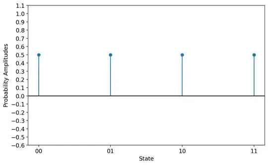

  1. Place qubits in equal superposition:
$$ \begin{aligned} |\psi_1\rangle &= \frac{1}{\sqrt{2^n}} \sum_{i = 0}^{2^n} |i\rangle \\ \\ &= \frac{1}{2}\left(|00\rangle + |01\rangle + |10\rangle + |11\rangle\right) \end{aligned} $$
If we graph the probability amplitudes for each state, it will look like this: step_1

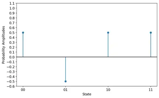

  1. Apply the oracle $U_f$ to "flip" the probability amplitude of the marked element (since you mentioned you know how this works and how to construct the circuit, I won't go into details). For argument sake, let's assume the marked state is $|01\rangle$:
$$ |\psi_2\rangle = \frac{1}{2}\left(|00\rangle - |01\rangle + |10\rangle + |11\rangle\right) $$
step_2

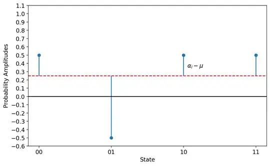

  1. "Flip" all probability amplitudes $\alpha_i$ about the mean. So, for this, we need to compute the mean $\mu$, which is easily done by adding all probability amplitudes and dividing by the total number of elements ($2^n$):
$$ \begin{aligned} \mu &= \frac{1}{2^n}\sum_{i = 0}^{2^n} \alpha_i \\ \\ &= \frac{1}{4}\left(\frac{1}{2} - \frac{1}{2} + \frac{1}{2} + \frac{1}{2}\right) = \frac{1}{4} \end{aligned} $$

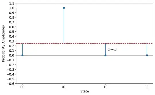

Notice that the distance between the current probability amplitudes $\alpha_i$ and the mean $\mu$ is simply $\alpha_i - \mu$, which pictorially looks like this: step_22
It is important to note that in the fig above we haven't changed anything with respect to step 2, we're just redrawing the amplitudes starting from the mean.

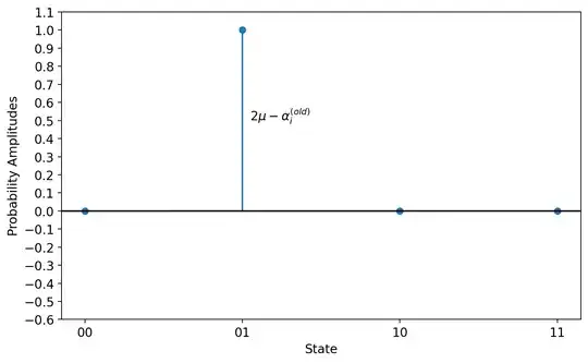

Now, after the reflection about the mean, the graph will look like this instead: step_3
The distance between each probability amplitude to the mean will still be $\alpha_i - \mu$, but now they will go in opposite direction. So the question is, what is the new value of each probability amplitude? (i.e., what is the distance from the $0$ line to the new $\alpha_i$?). Well, in general, that would be the distance from $0$ to the mean line minus the distance from the mean line to the amplitude $\alpha_i - \mu$, so we have:
$$ \begin{aligned} \alpha_i^{(new)} &= \mu - (\alpha_i^{(old)} - \mu) \\ \\\alpha_i^{(new)} &= 2\mu - \alpha_i^{(old)}, \end{aligned} $$
where $\alpha_i^{(old)}$ and $\alpha_i^{(new)}$ are each of the prob amplitudes before and after the reflection about the mean, respectively. step_32

This last matrix corresponds to a gate that inverts the phase of the all-zeros state, and the pre-factor of $−1$ is simply associated with a global phase we can ignore. To construct this gate, you can first flip all bits with an $X$ gate, apply a multi-controlled $Z$ gate on all qubits $\text{MC}Z$, and then flip the bits back with another $X$:
$$2 |0\rangle \langle 0| - I = X \, \text{MC}Z \, X .$$
Replacing in $U_s$, you get the following sequence of gates: $$U_s = H \, X \, \text{MC}Z \, X \, H,$$
where, again, all of these are being applied to all qubits. And this expression is exactly the circuit you have in your diagram.
