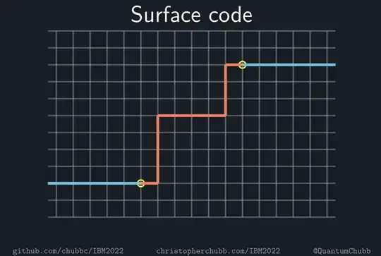

Consider the violated star stabilizers indicated by the two yellow circles in the image below. The correction indicated with the blue line has weight 12 and the correction indicated with the red line has weight 13. enter image description here

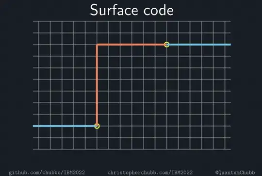

The blue line is the only correction of length 12, while there are topologically equivalent red lines that have length 13: enter image description here

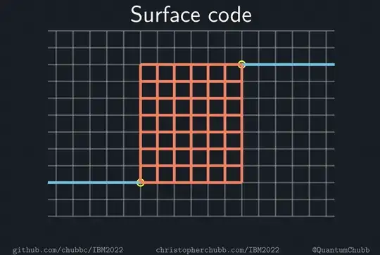

All corrections of weight 13 are indicated by the red grid: enter image description here

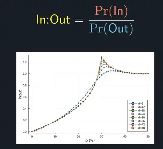

A maximum likelihood decoder will apply the correction indicated by the red line if the probability of the errors indicated by the red lines is higher than the probability of the error indicated by the blue line. The minimum weight decoder will apply the correction indicated by the blue line.
For this specific example and toy noise model, this happens if the probability of a single error is around 30%, as shown in the plot below.
These screen shots are from Christopher Chubb's lecture at the IBM summer school.
