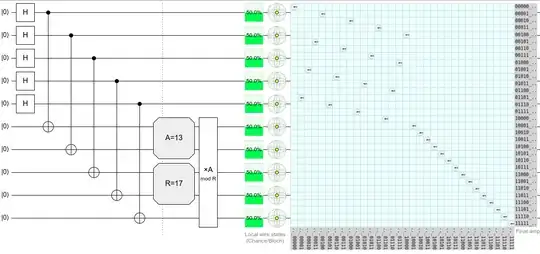

If you look at what happens inside a specified row k, this matrix is moving the 1 from column k to column k*n+1. Then it does something special in row n-1. So this is an inverse-permutation corresponding to a multiplication, then an increment, then a fixup exchanging two states.
All those operations can be implemented in O(log^2 n) gates. In fact you can get down to O(log(n) log(log(n)) log(log(log(n)))) by using Schönhage–Strassen multiplication, though that would have bad constant factors.
Basically: the hard part of your problem is multiplication. Look up how to do modular multiplication, pick a prime P larger than n^2, and then look at the permutation you get by performing an inplace modular multiplication by the multiplicative inverse of n mod P. You'll see it has this each-row-advances-n-steps property you're looking for, which you can then tweak into a full solution.
