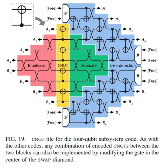

The paper "Logical Qubit in a Linear Array of Semiconductor Quantum Dots" has a construction of a fault tolerant code with a threshold using nearest neighbor interactions on a 1d line of qubits.
