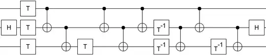

I believe I've got it down to 9 controlled-not gates: enter image description here
What I did was I used a set of three cNots in the place of Swap to move the two controls next to each other to achieve the last part of the standard Toffoli circuit (see here). This used 12 cNots.
However, the final $T$ and $H$ gates on the target qubit I propagated through one of these swaps. This let me cancel two controlled-Nots.
Then, in the final SWAP, I chose the first of the controlled-nots to be controlled from the middle qubit. I replaced it with a controlled-phase and two Hadamards. The leading Hadamard cancelled. The controlled-phase gate commutes with the preceding controlled gates controlled off the middle qubit, and phase gates on the middle qubit and bottom qubits. These operations bring that controlled phase up to a controlled-not from the first inserted swap. Hence, we can combine these two gates as a controlled-$iY$, controlled off the bottom qubit. But this can be written as a single cNot with some $S$ gates.
I've made no attempt at an optimality proof, but I'm already pretty pleased to have got it this small.

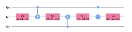

If you allow for a relative phase you can get your circuit to 3 $CNOT$s and 4 $U$ gates.
Minh Pham
  • 101
