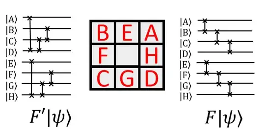

Circuits for front face
With such a set-up, the circuits that implement the permutations may be as above. Here, $\text{A,B,}\cdots$ are fixed registers of qubits (qutrits) of the cells on the front face, $F$ is a clockwise quarter-turn of the front face, and $F'$ is a counter-clockwise quarter turn. (The corner and cells adjacent to the front would also be permuted in a similar fashion).
