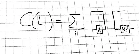

You can use the Kraus operators $K_i$ of $L$ and write
Choi matrix
EDIT: Of course, this requires the existence of Kraus operators, which is equivalent to $L$ being completely positive.
