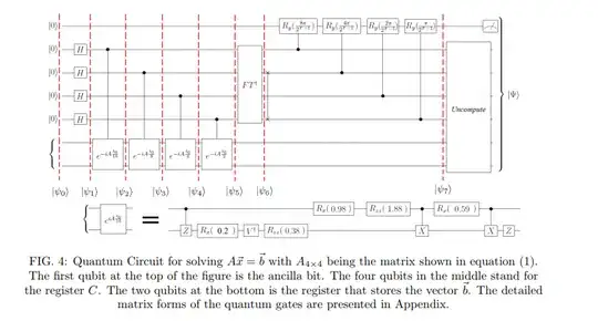

Following @DaftWullie's answer I tried to simulate the circuit given in Fig. 4 of the paper (arXiv pre-print): Quantum circuit design for solving linear systems of equations (Cao et al, 2012), on Quirk.
The relevant circuit in the arXiv pre-print by Cao et al is:
Please note that (I think) the $e^{-iAt_0/2^s}$ (s.t. $1\leq s \leq 4$) gates in the circuit should actually be $e^{+iAt_0/2^s}$ gates instead. That's probably a misprint in the paper.
You will find the equivalent Quirk simulated circuit here. The labellings of the gates (along with the matrix entries) can be seen from the dashboard by hovering over them. The matrix entries may also be obtained from the JSON code in the URL. You might want to use a JSON formatter for that purpose.
The rotation gates used in the paper are $R(8\pi/2^{r-1}),R(4\pi/2^{r-1}),R(2\pi/2^{r-1}),R(\pi/2^{r-1})$. On page 4 they mentioned that higher the value of $r$ they greater is the accuracy. So I took $r=7$.
I created the custom gates $R_y(8\pi/2^{r-1})$, $R_y(4\pi/2^{r-1})$, $R_y(2\pi/2^{r-1})$ & $R_y(\pi/2^{r-1})$, using the definition of the $R_y$ matrices as:
$$R_y(\theta) = \left(\begin{matrix}\cos(\theta/2) & \sin(\theta/2) \\ -\sin(\theta/2) & \cos(\theta/2) \end{matrix}\right)$$
Now, the output state of the "input register" should have been
$$\frac{-|00\rangle + 7|01\rangle + 11|10\rangle + 13|11\rangle}{\sqrt{340}}$$ i.e. $$-0.0542326|00\rangle + 0.379628|01\rangle + 0.596559|10\rangle + 0.705024|11\rangle$$
However, I'm getting the output state of the input register as
$$-(-0.05220|00\rangle+0.37913|01\rangle+0.59635|10\rangle+0.70562|11\rangle)$$
That is, there's a extraneous global phase of $-1$ in the final output. I'm not sure whether I have made a mistake in the implementation of the circuit OR whether the output of the circuit actually supposed to be accompanied with the global phase.
@DaftWullie mentions:
If it's a global phase, what does it matter? Everything is always "up to a global phase"
That sure is logical! However, I want to be sure that I'm not making any silly error in the implementation itself. I wonder that if there's actually supposed to be a global phase of $-1$, why they didn't explicitly mention it in the paper? I find that a bit surprising. (Indeed, yes, I should perhaps directly contact the authors, but maybe someone here might be able to spot the silly mistake (on my part) quicker! :)
In case you have any questions about my simulation, please feel free to ask in the comments. I'll be happy to clarify.
