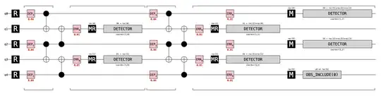

The circuit looks like this:
So, we are basically starting with the data qubits in state $|0\rangle^{\otimes 3}$, and then measure the observables (in this case $Z_1Z_2$ and $Z_2Z_3$) to get a logical $|0\rangle_L$ in repetition code (up to possible -1 outcomes which we don't care about). After performing as many error correction cycles as we feel like, we measure $Z_1$, $Z_2$, as well as $Z_3$, which each are logical $Z$ observables.
The neat thing now is that by measuring not only one logical observable (which in the noiseless case gives exactly as much information as measuring all three of them) but all three, we get once more syndrome information: We know that the product of the outcomes of the $Z_1$ and $Z_2$ measurements in the noiseless case would be equal to the outcome of the $Z_1 Z_2$ stabiliser measurement in the last error correction round. This is crucial: If, for example, in the whole circuit, there was no error happening, but in the very end, right before the logical measurement of the first qubit, there was an X-error, we would be screwed if we'd only measured this first qubit to measure the logical observable. But since we basically get one more round of repetition code error syndromes from these three observables $Z_1$, $Z_2$ and $Z_3$, our decoding algorithm can understand that the whole error syndrome flips the value of the logical observable $Z_1$.

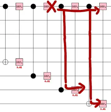

Hook Errors
Suppose an X error occurs on the measurement qubit halfway through performing the CX and CZ gates that you've decomposed a four-body measurement into. This error anticommutes with the following two controlled gates, causing it to spread to their targets, creating two data errors.
Hook errors are tricky because they're often worth multiple data errors. You have to be very careful about the order you do things, to avoid hook errors reducing the distance. In the case of the [[5,1,3]] code I doubt there's any ordering that works, because the set of possible symptoms is 1:1 with the set of single qubit errors so there's no room left to describe these 2 qubit errors.
One way to bypass the hook error problem is to change the strategy you are using for measuring the stabilizers. Well known strategies are "the steane method" and "the Shor method", as well as flag qubits which catch the hook error by using two measure qubits prepared in $|00\rangle + |11\rangle$ instead of one measure qubit prepared in $|+\rangle$.
