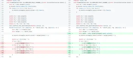

Update: This is fixed in stim~=1.12.1 and in stim~=1.13.dev1701377008. The only stable version affected was 1.12.0, since HERALDED_PAULI_CHANNEL_1 was released in 1.12.
This is a bug. Good catch. I've written a fix and am merging it: https://github.com/quantumlib/Stim/pull/676. Also added some tests that verify it's fixed. I also checked HERALDED_ERASE, which historically was added at the same time but didn't have the same bug.
Within two hours you should be able to pip install stim~=1.13.dev and get a version with the bug fixed. I'll also backport the fix to 1.12 and release a version 1.12.1. That should be done before the end of the day.
